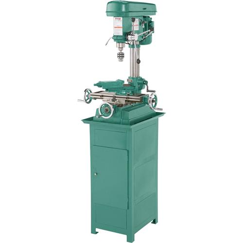

Image for Grizzly G0517 - 6" x 16" Mill/Drill with Stand
Don't let the price fool you! Not only do you get a Mill/Drill with 5/8" capacity, double lock column, 12 spindle speeds and a 9-1/4" x 5-3/4" table travel, but you also get a stand and milling vise too! Check out all the details below.
Features:
  • 5/8" drill chuck
  • Machine vise
  • MT #2/#3 and MT #1/#2 adapters
  • Adjustable gibs on table
  • Head rotates a full 360º
  • Spindle draw bar thread size: M12-1.75
  • Spindle taper: MT #3
  • Spindle travel: 3-1/8"
  • Swing: 14-1/2"
  • Max. distance spindle to table: 14"
  • Max. distance spindle to column: 7-1/4"
  • Column size: 2-53/64"
  • T-Slots: 2 @ 3-3/8" centers, 3/8" Studs
  • Table size: 6-1/2" x 16-1/2"
  • Longitudinal table travel: 9-1/4"
  • Cross-slide travel: 5-3/4"
  • Drilling capacity: 5/8"
  • Number of speeds: 12
  • Range of speeds: 300, 400, 540, 720, 900, 1040, 1500, 1740, 2100, 2260, 3100 & 3840 RPM
  • Motor size: 1/2 HP
  • Approximate shipping weight: 289 lbs.
