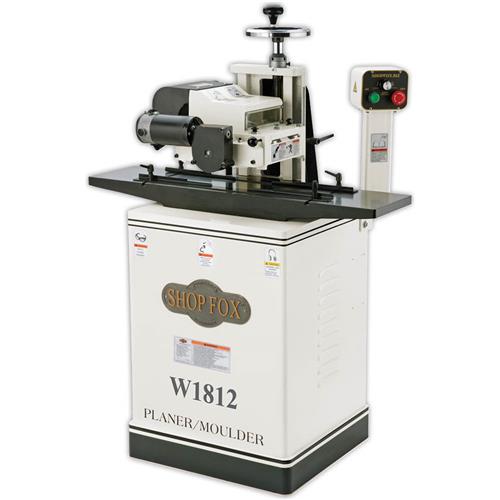

Shop Fox W1812 2 HP 7" Planer / Moulder
Create your own custom mouldings!
The next generation W1812 2 HP 7" Planer / Moulder features precision-ground cast-iron wings for increased work support and T-slots for easy guide rail adjustment.
The pedestal-mounted controls allow you to adjust the variable-speed feed motor for unsurpassed control over planing and moulding cutting results.
The open-end design allows you to make curved mouldings with the optional elliptical jig.
If you make your own mouldings and frames, you need this machine!
